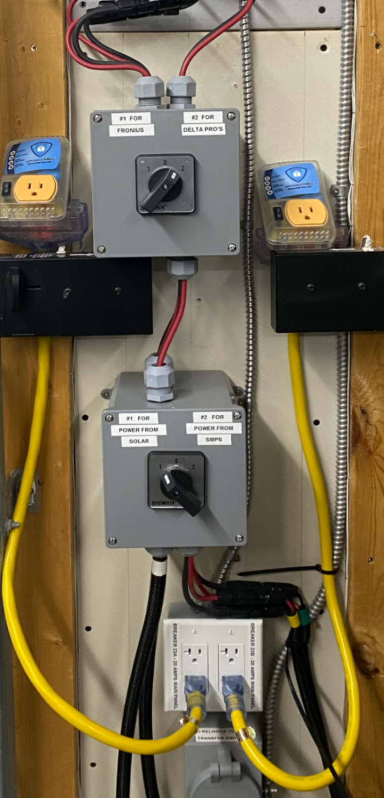

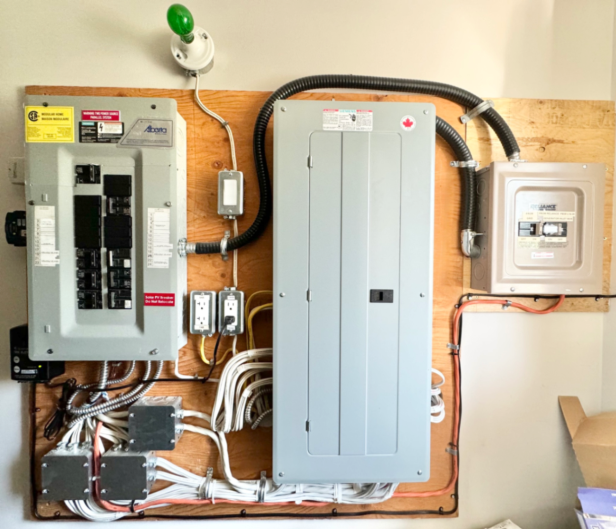

DELTA Pro Set up used since May 2022 to power my whole house

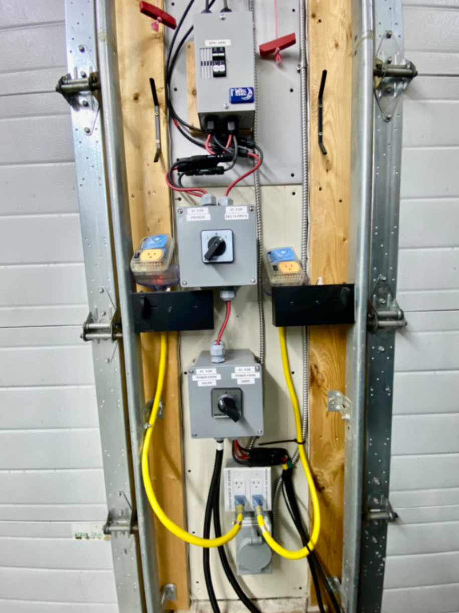

Update #1:Additions since original post:EcoFlow WaveDual Fuel Smart Generator6 more solar panels2 Long lifetime 0-60v 72v 110V 18A 2000W 110V 220V AC to DC PFC SMPS Modular Switching Power SupplyFronius Primo Grid Tied InverterUpdate #2:November 23-2022Added rotary cam switches to select inputs and outputs from solar or SMPSInstalled new Ideal Pulsing 2,000 watt Switch Mode Power Supplies (SMPS) that effortlessly output 1,600 watts to each DP
Update #3 January 13-2023Added Victron Autotransformer to balance both phase outputs from the DVH. A HUGE shout out and "Thank you" toTre Ntfor forging the path for us on this as he blazed the trail for me on this topic.
Update #4 - June 12-2023Added Delta2Max and Wave2
Update #5 - July 5-2023Upgraded my Uline shelf system
Update #6 - November 10-2023Added Delta2
Update #7 - May 17-2024- Added two 240 volt 20 amp NEMA 6-20R outlets each on their own dedicated 20 amp 2 pole breaker to facilitate charging with SMPS using 240 volts or charging DP with AC power at 240 volts using a 14 AWG 6-15P to C13 power cable.
Update #8 - May 26-2024- Added rotary cam switch on Victron Autotransformer to be able to select between outputting 240 volts at 15 amps with only one single Delta Pro or outputting 240 volts at 30 amps with 2 Delta Pros.
