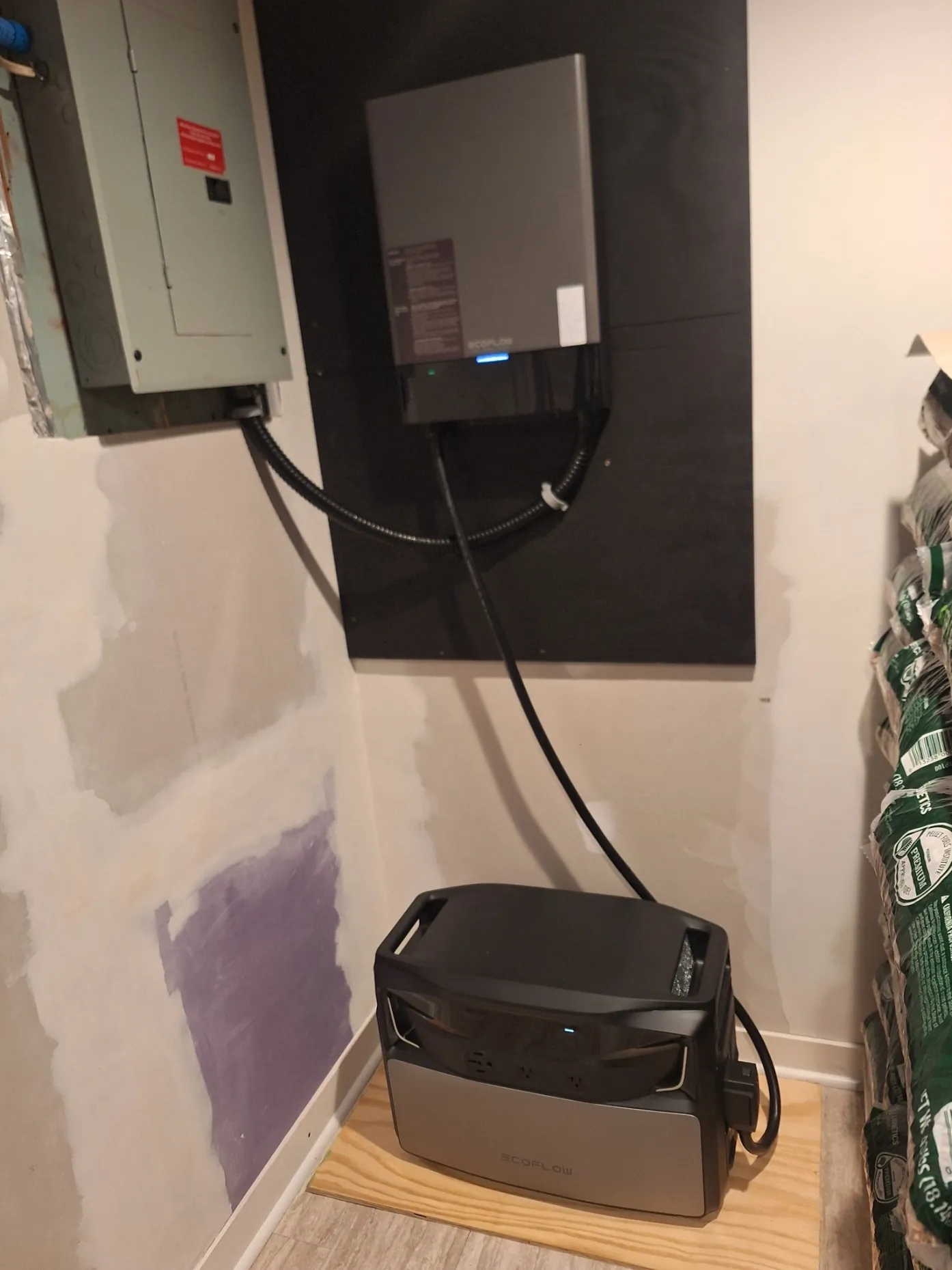

I am lucky and was selected as a beta tester for the SHP10 / Titan Plus and I want to thank the EcoFlow team for this opportunity!
I have never used a smart panel before, and the manual was for installation, so figuring out things was very frustrating for me (the manual has since been released). I was also using the beta App, as I was instructed, so the regular app may produce different results.

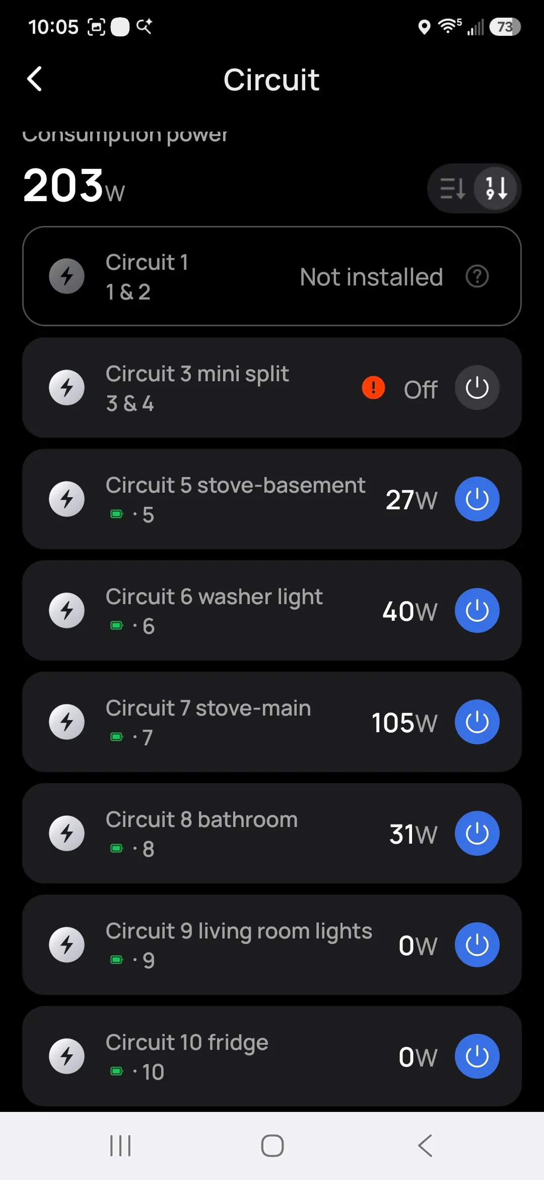

The SHP has, nominally, 10 circuits, although the first 2 are set up for an electric dryer, which I chose not to have hooked up. My mini split took up circuits 3&4, with the rest taken by pellet stoves, refrigerator and various lights.

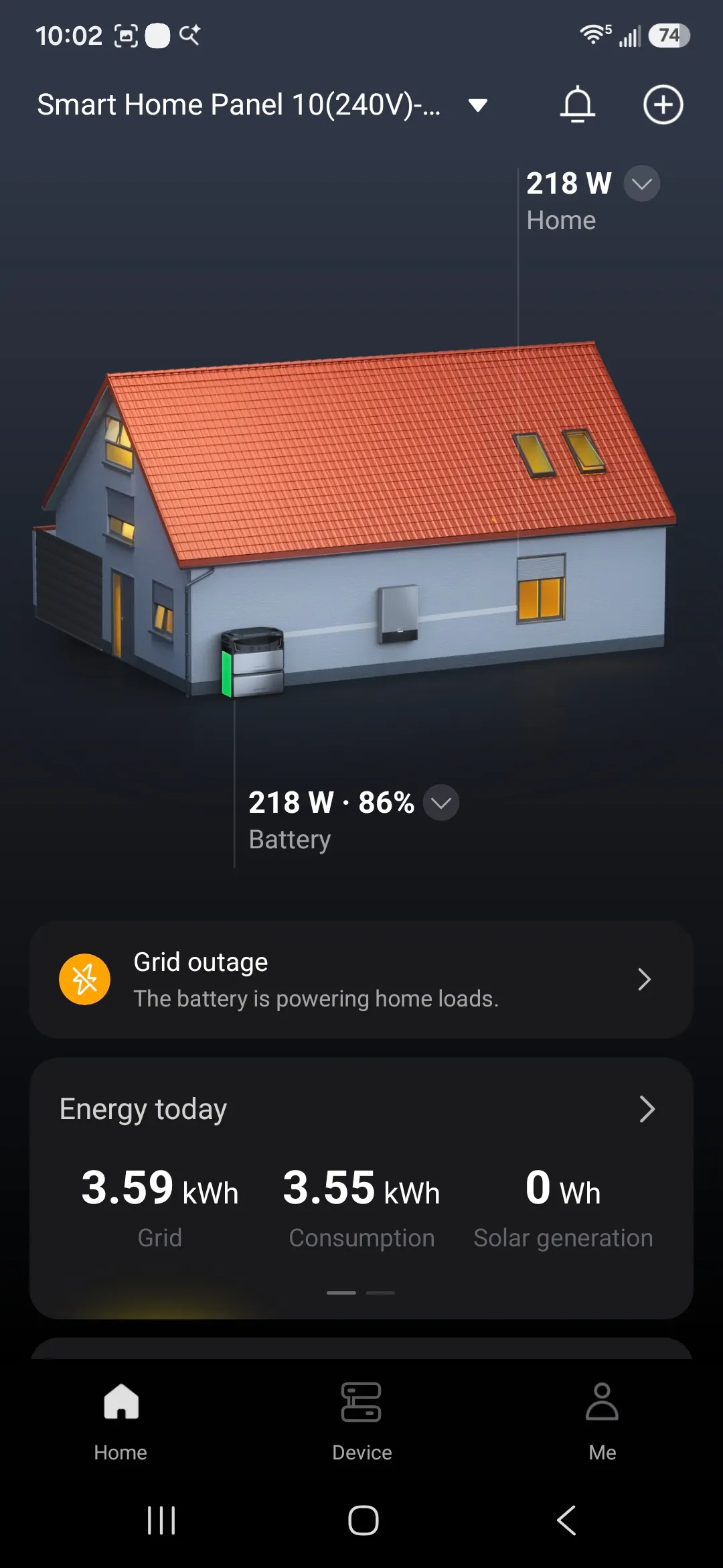

1st, I'd like to say, for every simulated outage I tried, by flipping my main breaker switch, the entire system worked flawlessly in providing power to my selected circuits. That performance was rock solid and impressive for those of us who have only used an MTS, or stations at POU.
Setting up the circuit priorities was easy, and priorities could be changed on the fly. Non-priority circuits are not turned on during power outages, but they can be switched on thru the app. I could also tell how much power was being pulled by each circuit and see real time changes as I turned things on/off.

Flawless backup performance, with some hiccups that should be addressed in future updates.
