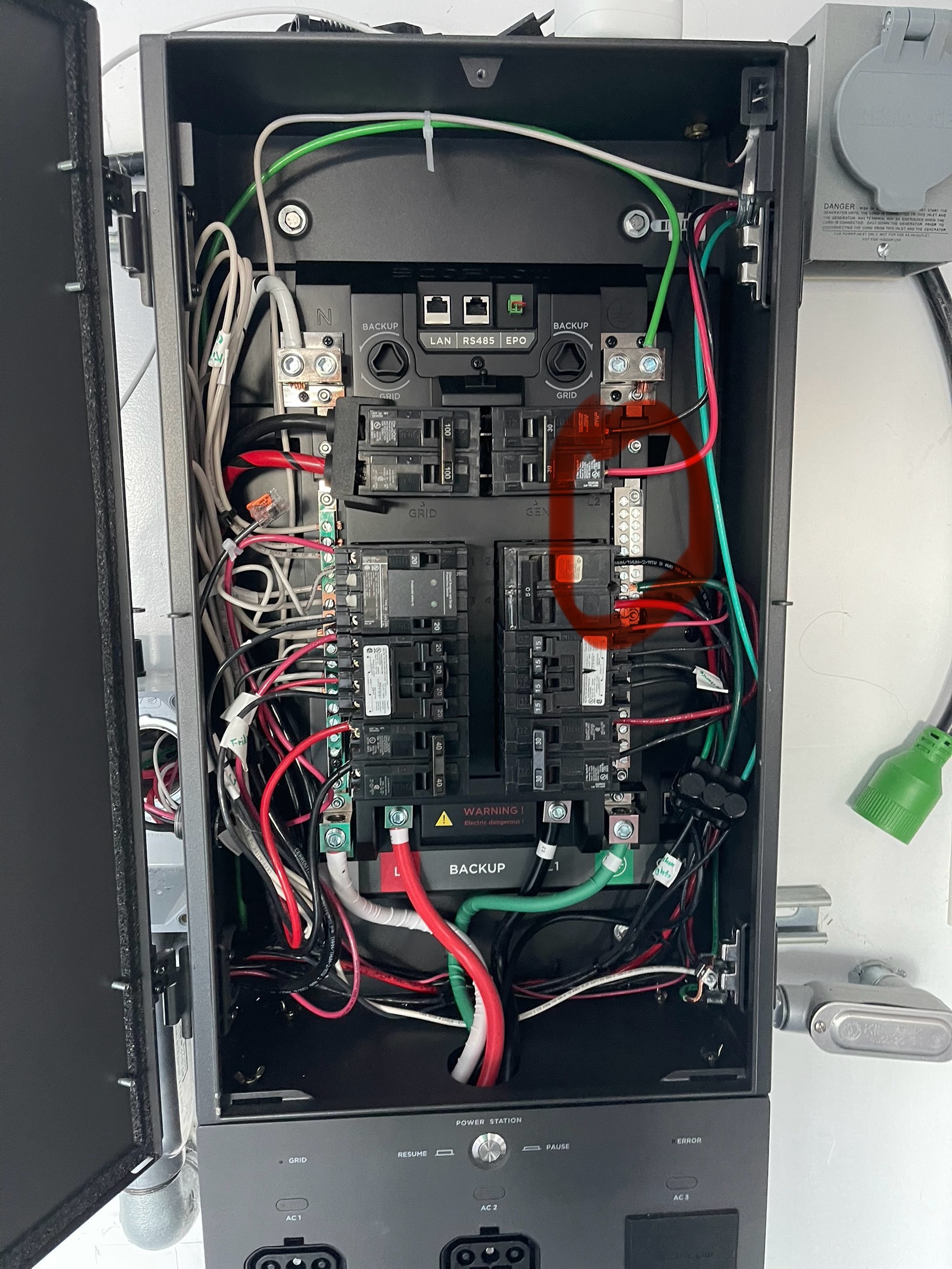

I think a lot of the SHP2 panel issues stem from installation issues. My install is one of the oldest in the US as I am a beta tester and I have had ZERO issue with my SHP2 in over two years.
i want to bring some pointers here. Read the manual!
Also, it’s not obvious, but the circled area in my picture is GROUND bus, not neutral. I seen installs where neutral are landed there and cause accidental ground - neutral bond which is a NO go.
