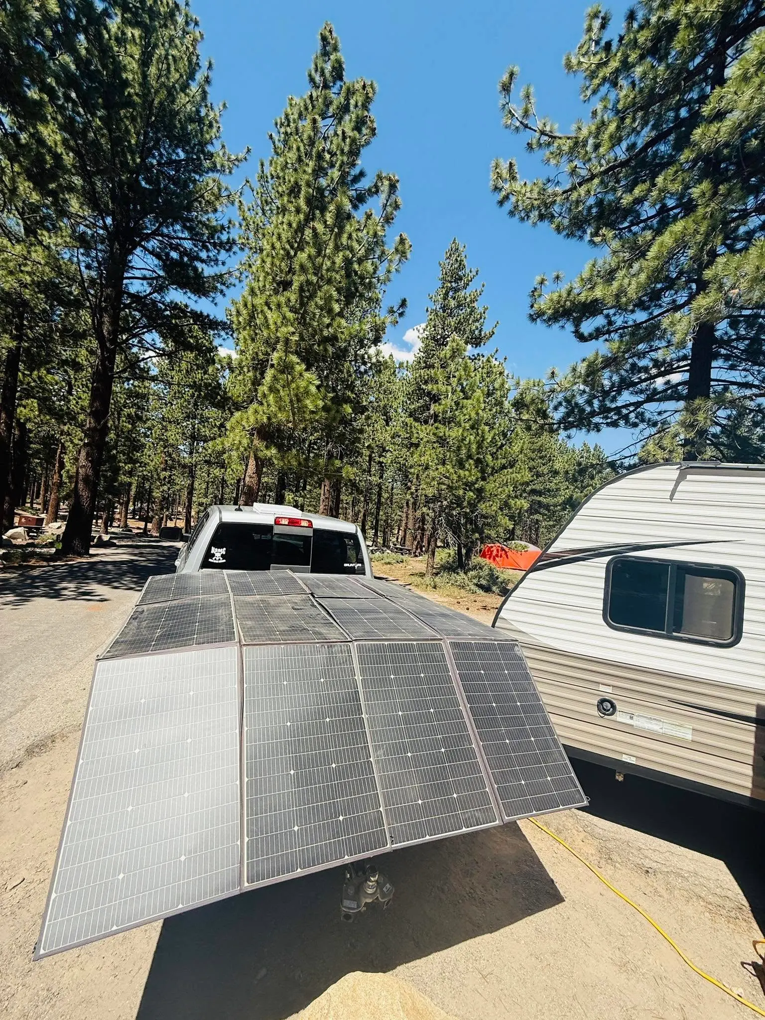

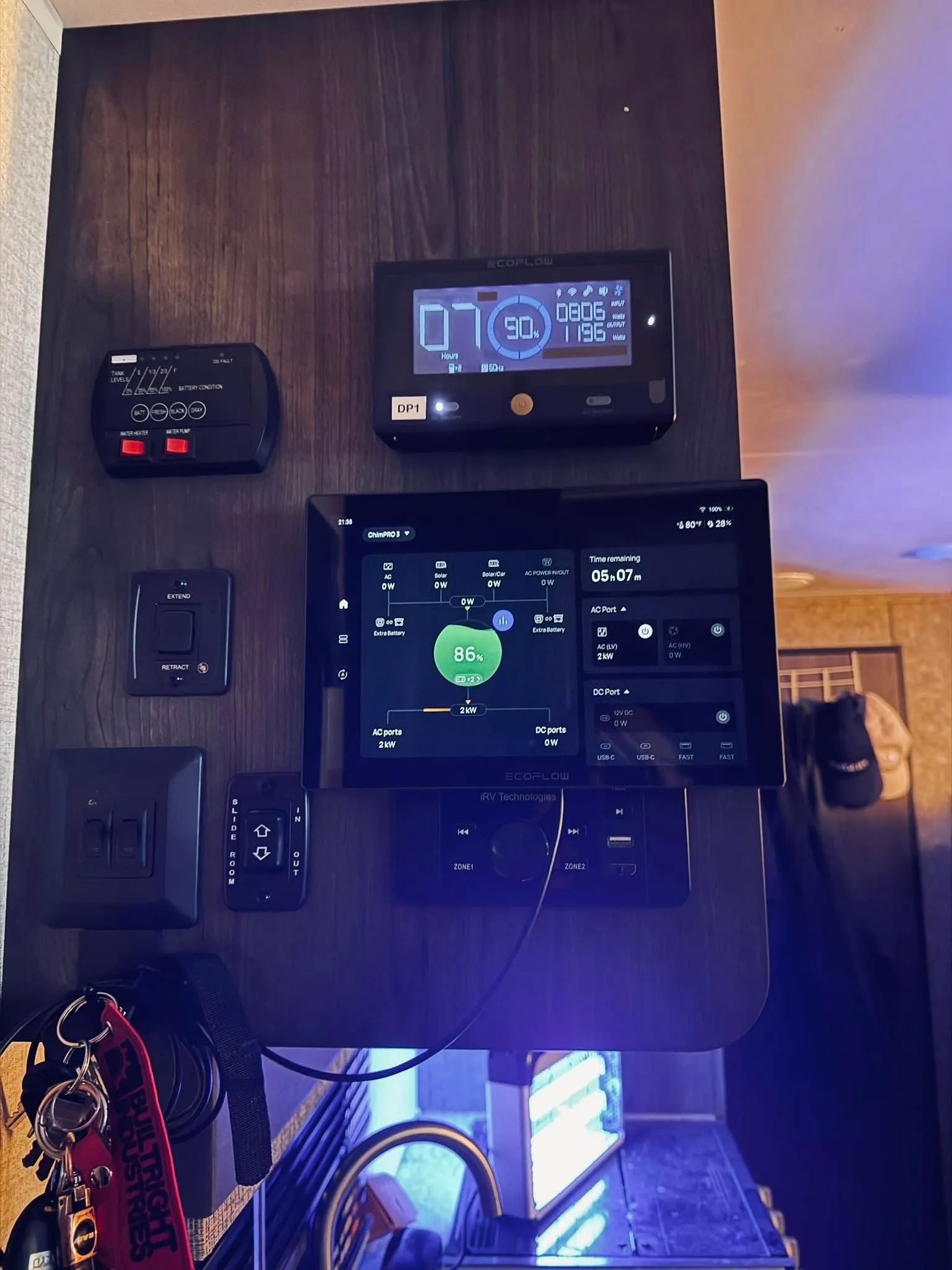

In preparation for the hot weather, I just want to share my Ecoflow gear I use when I go out boondocking in the summer time. Last year I went on a camping trip spending a couple of days in the hot desert, and ending it with three days in the Eastern Sierra mountains. SoCal was in a middle of a heatwave, so I brought all my EcoFlow toys to make my RV comfortable by powering my 13,500btu air conditioner with no soft start all week long. I brought my original Delta Pro and one extra battery inside my truck connected to my Alternator Chargers. I have my Delta Pro 3 with two extra batteries as my main power supply for my trailer. And I have three LiTime 12.8v 280AH batteries wired in series with a 3k inverter. For those doing the math, that’s 30.1kWh worth of power. I used the DP3 as my main power supply because of it’s 4kw inverter. Since I don’t have a soft start, the LiTime batteries and it’s 3kw inverter wouldn’t be able to handle the surge. So I would just plug the DP3 straight into my inverter to replenish as needed. I run my EF SG4000 during the day when solar isn’t keeping up. And finally I use my original DP in my truck to power my Starlink Gen3 and also quietly power dump to my batteries in my trailer during the night as needed. Now some may think it’s overkill, but I think it’s perfect. I ran my air conditioner and stayed comfortable using electricity with impunity. All my EcoFlow products ran perfectly making my spontaneous weeklong camping trip comfortable.
