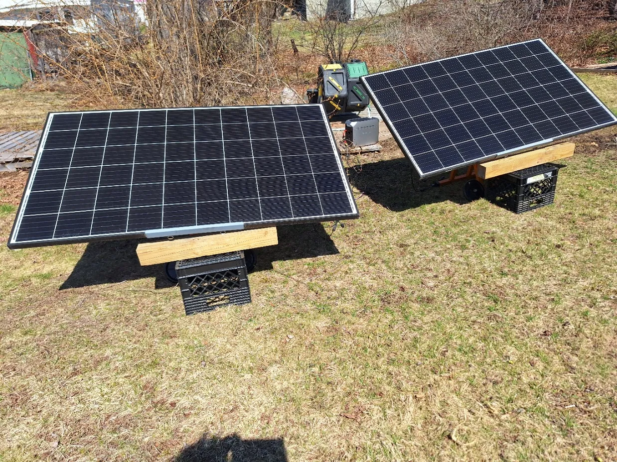

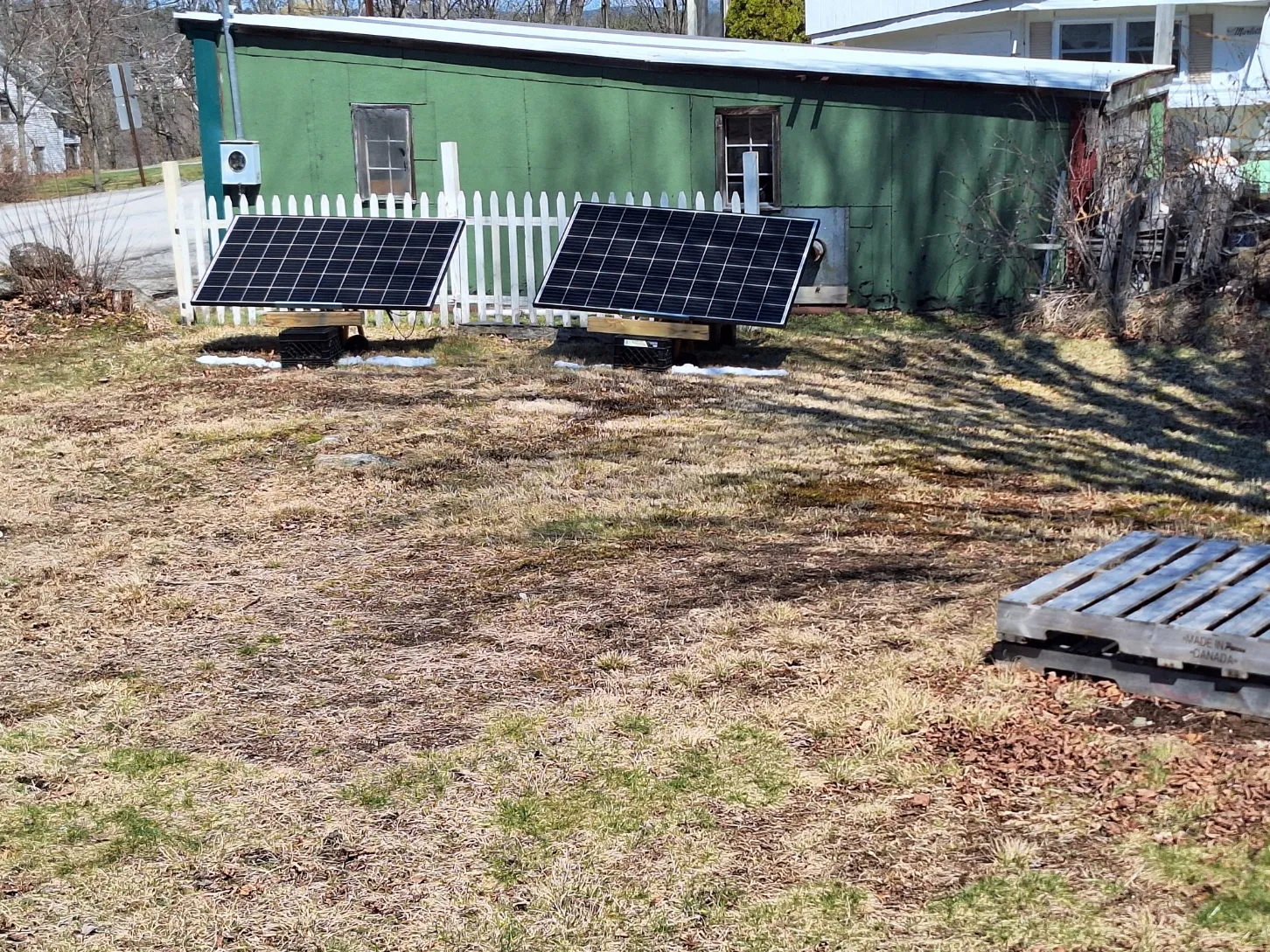

What I have not been vocal about lately is the fact that I still have 2 of the same panels that I use on portable ground mounts. These two panels have been my primary charging panels for the last 2 summers (along with some portable, folding panels). And they are rotated in the yard as appropriate for the season. During winter, I store those 2 rigid panels in a somewhat wind sheltered area, which keeps the panels from being blown over (1st pic). Facing south, they do grab later afternoon sun very well in that position (this time of year), but it is inconvenient and "LATER afternoon sun" were the key words. That 1st pic was taken at nearly 1 pm and one panel is still shaded by tree limbs (no leaves yet).

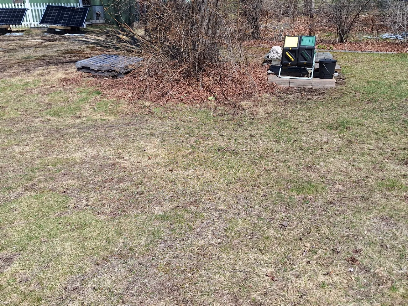

Now that the sun is crawling higher in the sky, I moved those two panels to my preferred summer position this past Wednesday. I can turn them towards the east, then south, then west, to catch the best sun possible. In the 3rd picture, the panels are in their latest placement, charging the D3MP.
Toward fall, they will be moved to a different place to catch the best sun and avoid shading issues from trees, neighbor's houses and even my own house. Then, back by the fence nearing winter.
