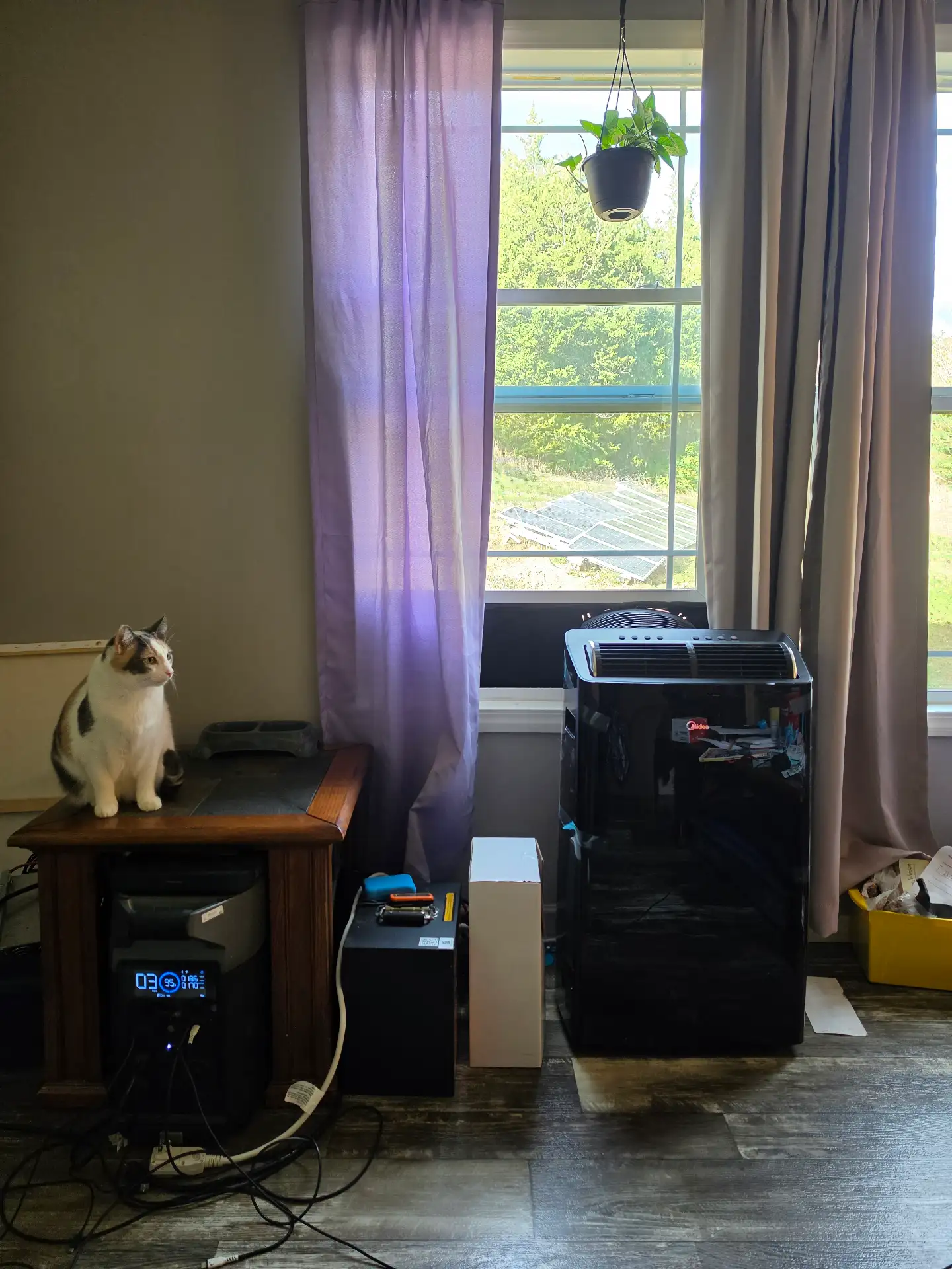

Delta Pro running 3 years strong!
The Delta Pro was purchased February 2023 and has got us through alot and has become the living room key item. From running necessities heat and air to being the ups to running the xbox and TV to just being a place to plug in devices throughout the day the delta pro has been a beast! Recently upgraded the portable air conditioner with heat to a midea duo with heat so being inverter style compressor i believe took that surge strain off the delta pro. Using a 1800 watt array I built out of scrap lumber and 18, 100 watt various panels I was able to get the voltage just right to be safe and effective, adding a 150ah lithium battery with 500 watt alternator charger , and the midea duo for some heat and air with excess solar I cant brag enough about this unit. Love the Delta Pro! Only reason I would upgrade to Delta Pro 3 is for the quietness! Lol
