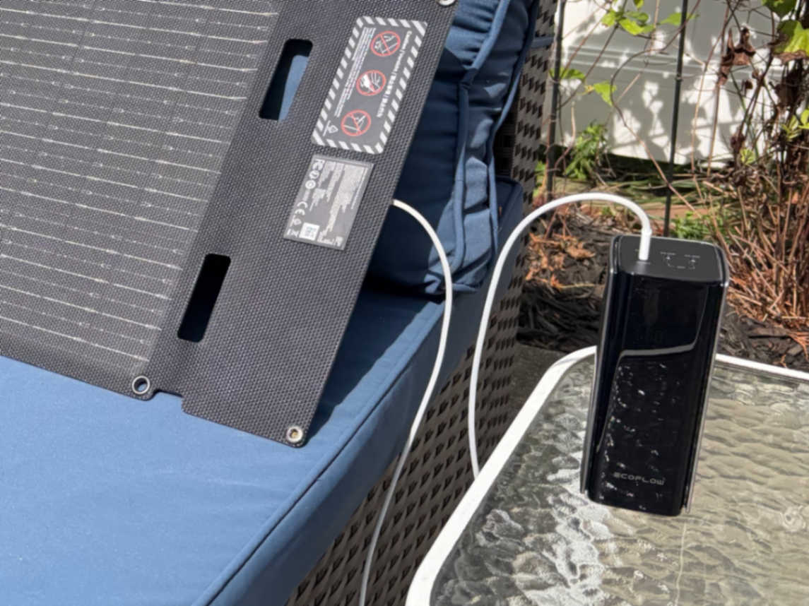

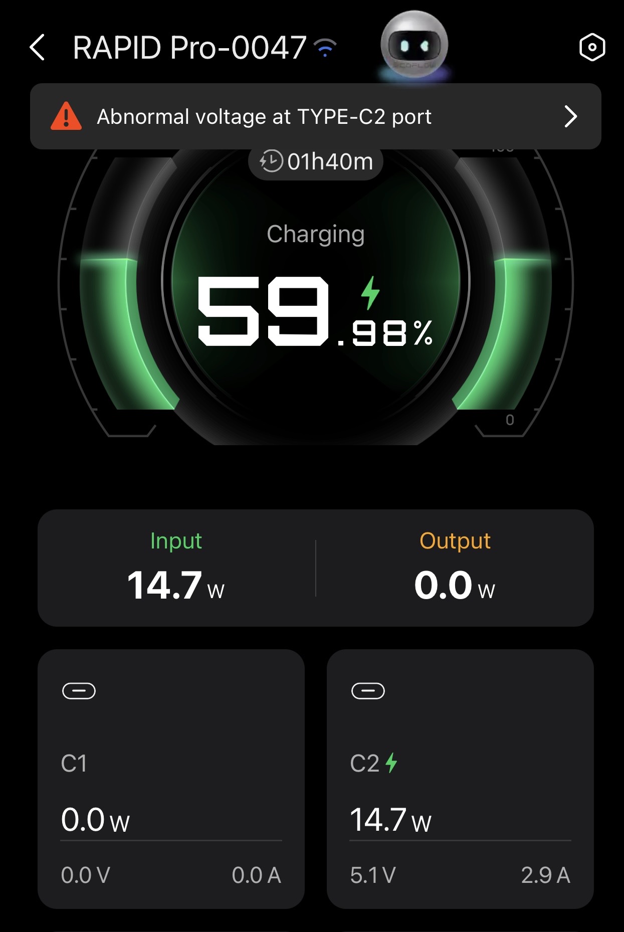

I had to try it. I connected my EcoFlow 45W and 60W panels directly to my 20,000mAh RAPID Pro using USB-C. Both panels got close to the 15W USB-C limit, but every time they approached it, the RAPID Pro showed an “Abnormal Voltage” error and the input dropped back to zero.
I didn’t expect this to work since it isn’t advertised as a supported setup, but it was still a fun experiment. The solar panels don’t provide the same stable output as a normal USB-C charger, and apparently the RAPID Pro wasn’t having it. 😄
