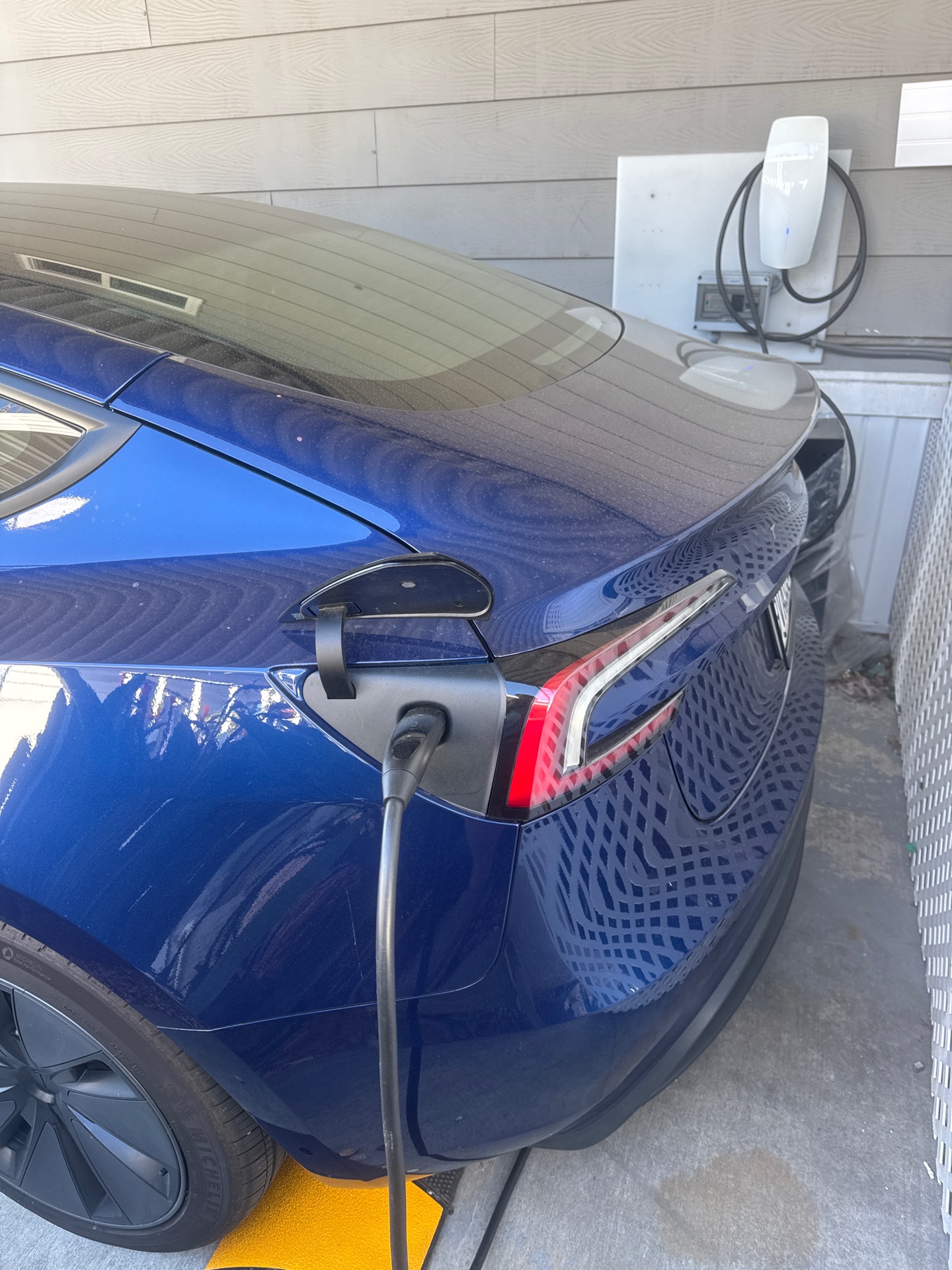

I charge my Tesla with the sun only.
I use two Ecoflow Delta Pro and an extra battery powered by 2.4kw of solar panels to charge my Tesla, power a refrigerator, microwave, tv, device charging station, Starlink internet and a coffee maker and a heater. I would love to see Ecoflow install firmware that had Boolean power control. Right now I use a timer to charge the Tesla only midday. Often times the battery banks are fully charged by 10am, but on cloudy days it may take longer. If the Ecoflow Delta Pro could automatically charge the Tesla when the the solar input is greater than 1.3kw and the battery banks are greater than 80%; I could get better use of the sun. My system is separate, distinct and isolated from the house power from the grid; so if I had Boolean functionality I could use an ABT to power my only large load left on the grid, my kitchen refrigerator. Please let me know if there is unit that does have Boolean logic.
