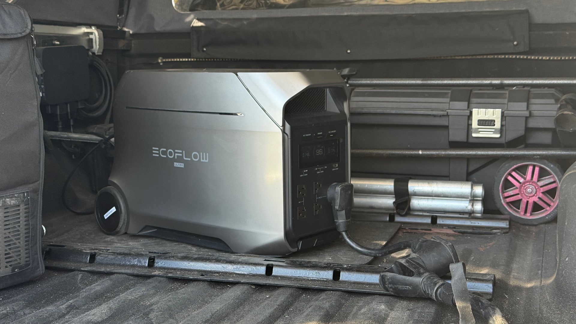

🔋 3,072Wh 🛞 Portable Design
At 74 lbs, the telescoping handle glides smoothly and the wheels roll effortlessly over both gravel and concrete. Moving it around the RV campsite has been incredibly easy.

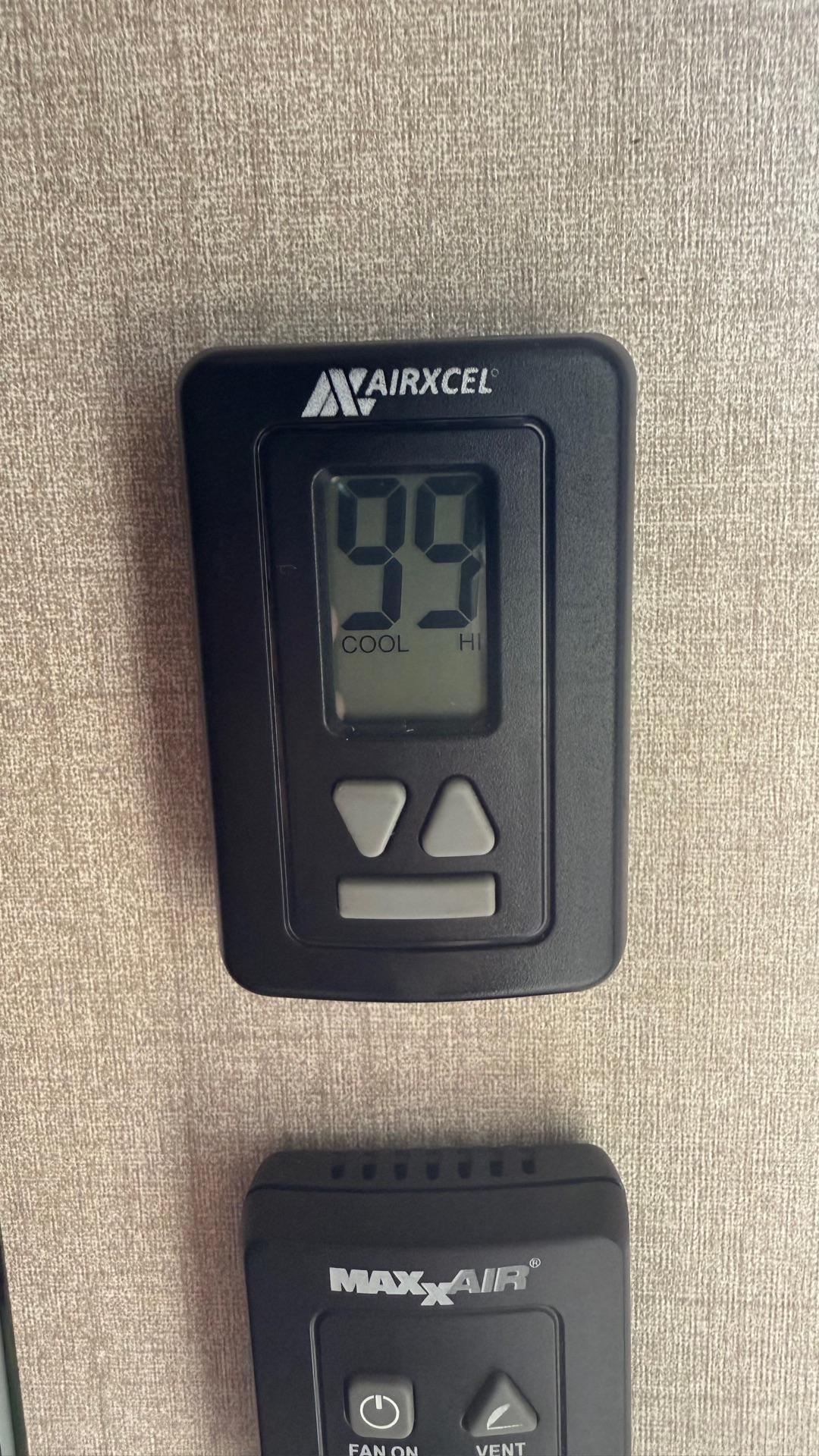

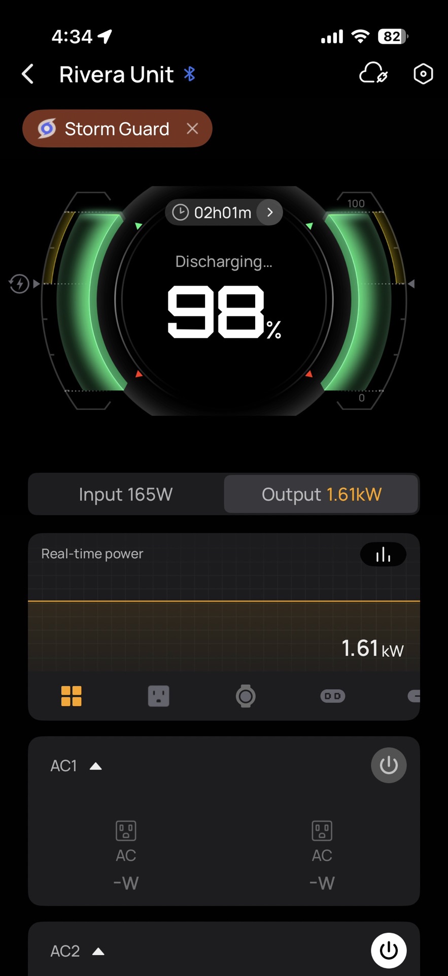

Connected the Delta 3 Ultra Plus to our Jayco North Point 30A fifth wheel with TWO 15K BTU A/C units equipped with SoftStarts.
✔️ One A/C unit running: ~1.6kW draw
✔️ Both A/C units running: ~3.2kW draw
✔️ Added the TV and lights: peaked at ~3.29kW
Result? No issues at all. The Delta 3 Ultra Plus handled everything without breaking a sweat. Having the ability to run both air conditioners and our everyday essentials gives us confidence whether we’re boondocking or dealing with unexpected power outages.
