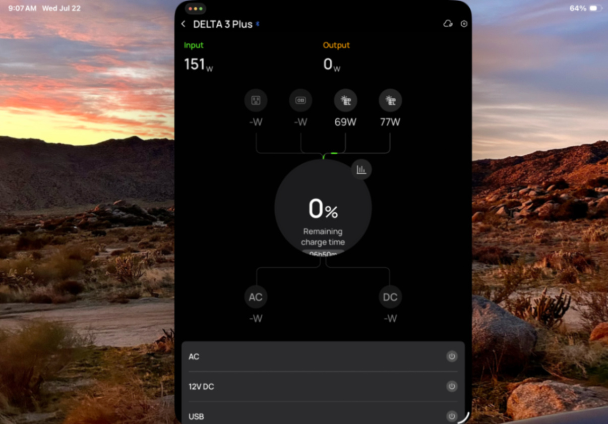

I was sitting at 40% and about 3 hours away from sun when I started to watch. The battery gauge was barely moving, even though I had a constant 100W draw on it. After 2 hours, I was down to 32%. I decided to speed it up and plugged the cooktop in, drawing 1.1kW, and took the box down to 5%.
My thinking was that I really didn’t want to be hitting it with that high of a load when it hit 0%, so I unplugged the cooktop and went back to just that 100W load. It finally settled on 4% and then took another 40 minutes to drain to 0%. I will eventually level off with around 220W of solar which should take about 5 hours to get to 100%
If the weather holds, I will attempt 3 full cycles and report back. I think it will be interesting to see the amount of solar it will take each time to go from 0% to 100% as the BMS is recalibrating.
