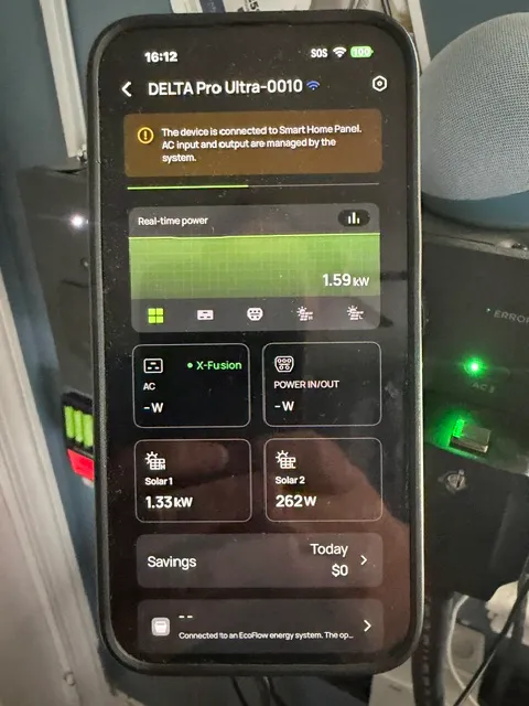

#Powerdifferent. As we know the Hashtag #PowerDifferent is exactly what I am doing here. Using other Power sources to keep my DPU/House off the Grid ,topping my DPU batteries when it has rained the last two days.

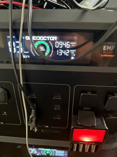

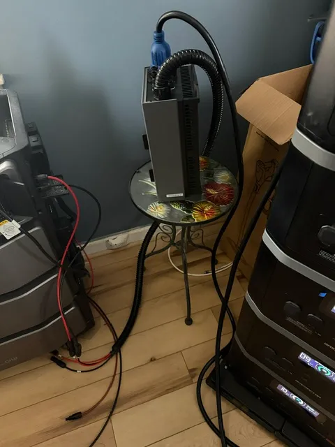

So its the end of the day, I come home and batteries are at 92%. Not bad ,but i was only at 80% when I left for work today. So in the theme of #POWERDIFFERENT I used my First power station I ever purchased and topped off the DPU using the Generator Rectifier . I run the RF 30 amp 120 v off this power station to the Flowmaster , then out using the solan cables into the DPU HV input. It allows 1343 watts input . Not bad for 120 v and using 500 watts of LV solar input to knock off the final 8% in 25 min
