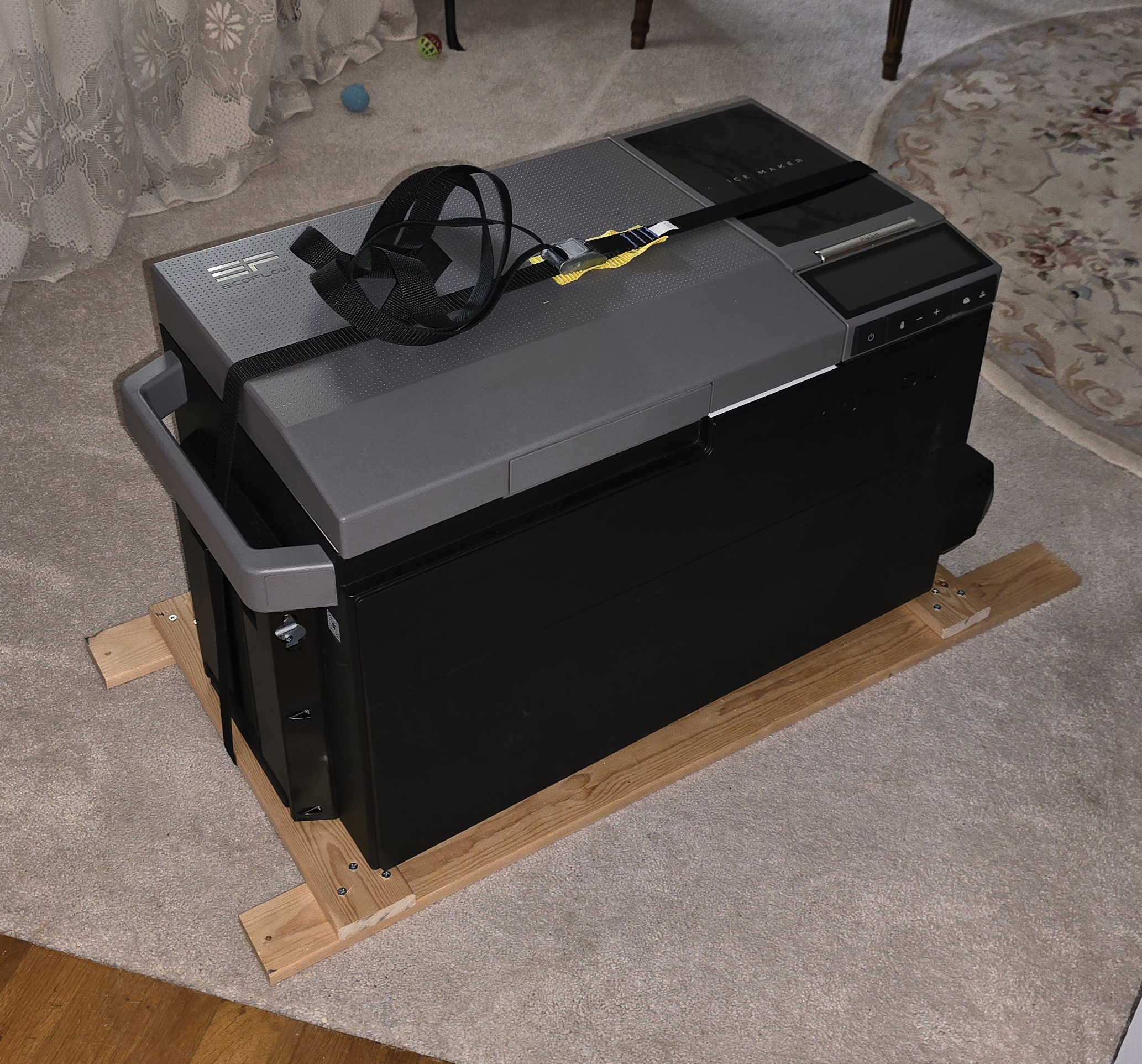

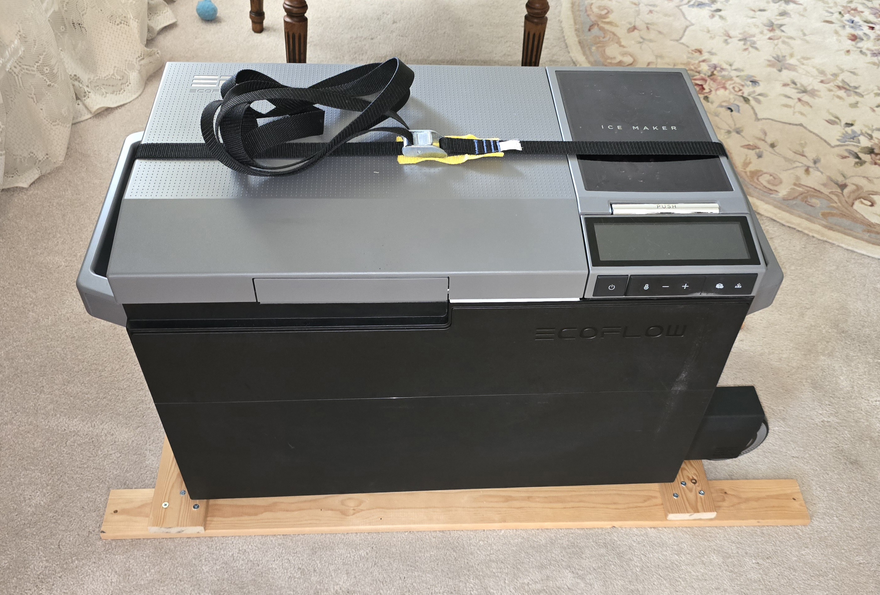

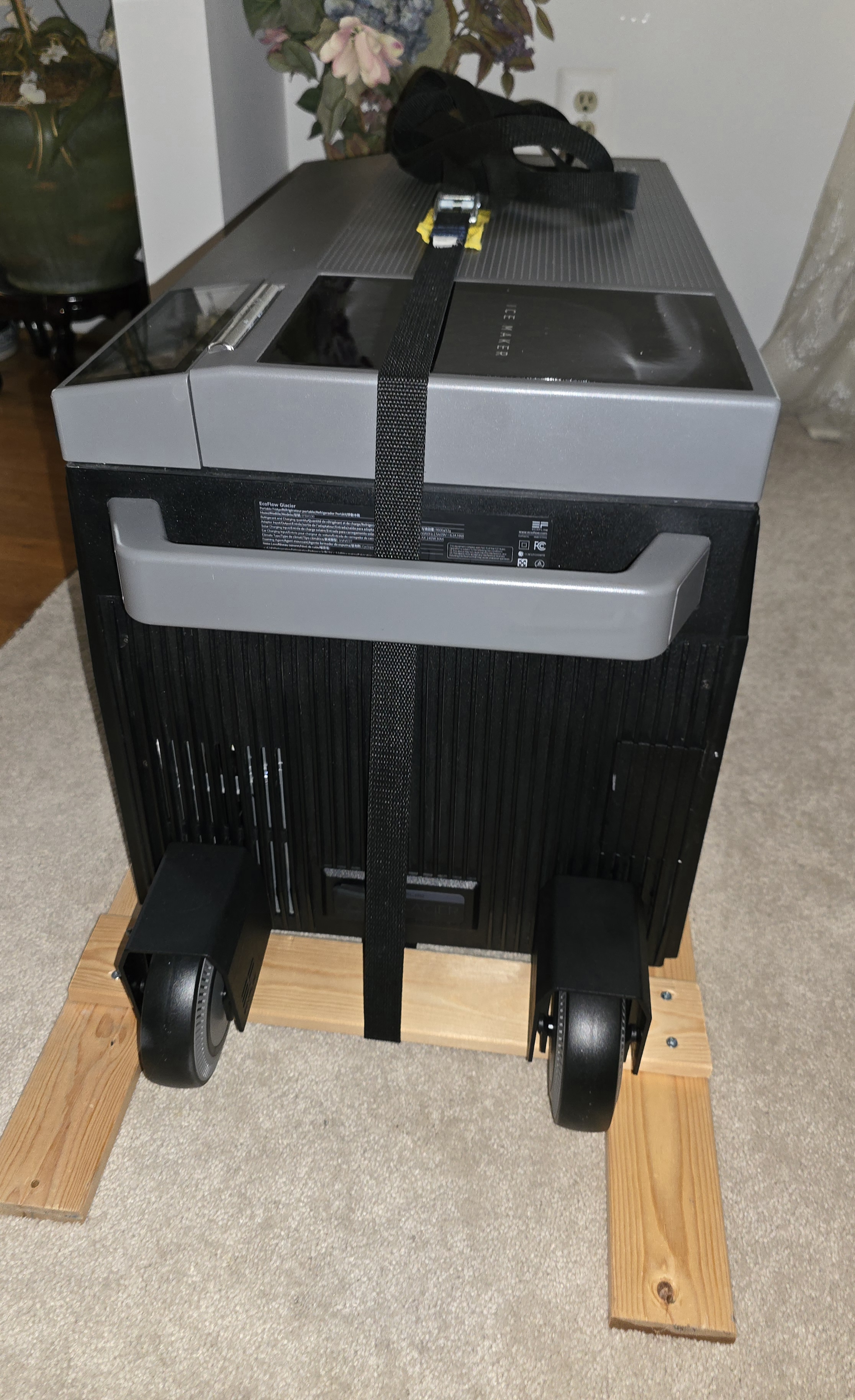

I needed to get my Glacier down to the basement - down a set of narrow, steep, stairs. The stairway is too narrow to take it down on any type of cart. So I built a simple sled. I just used four bits of wood I had laying around to make a platform tall enough to lift the feet/wheels off the ground, and smooth underneath, and strapped the glacier in place. It was then really easy to slide the unit down the carpeted stairs.
