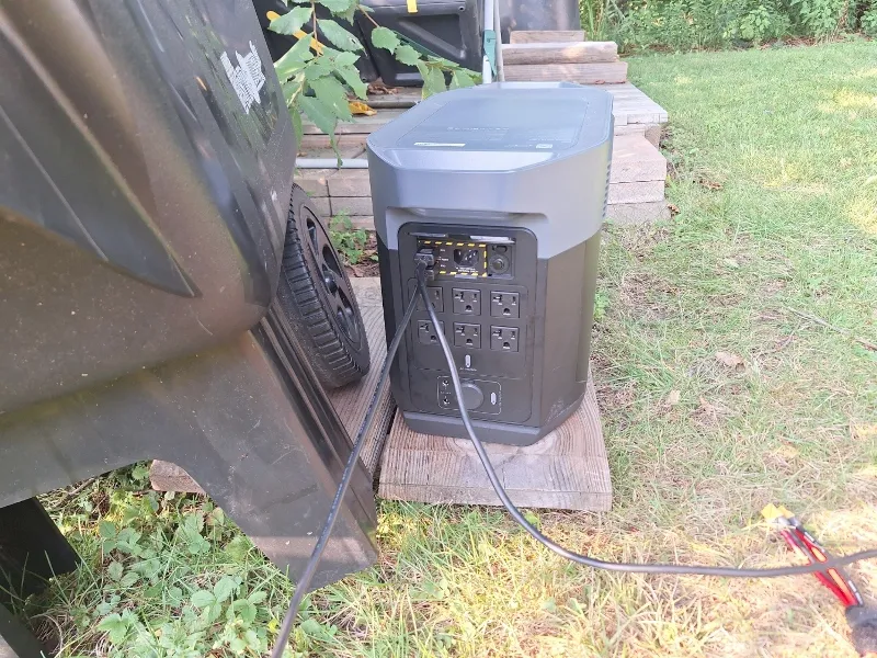

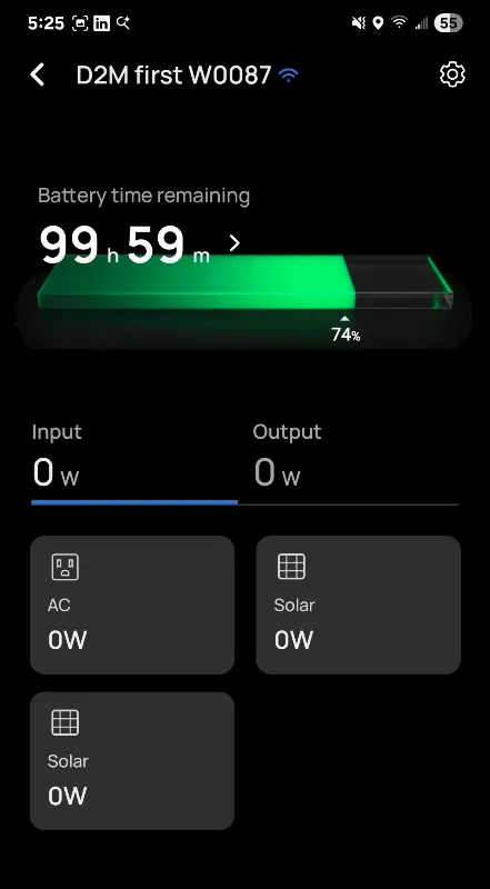

I had a weird thing happen with my Delta 2 Max (first) on Sunday. I took it outside for solar charging (as usual), hooked it up and all was going along fine. It had started around 35% and after a couple of hours was up to 74%. Then, next time I looked on the app, it was still at 74%, and showed no input from the solar panels.

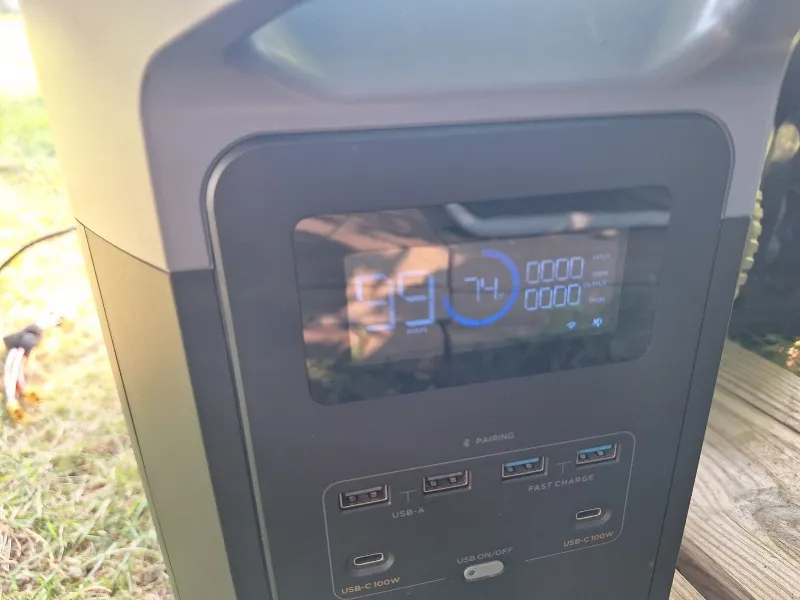

4) Turned the D2M off, and plugged the panels directly in. This woke the station up, and it showed charging for about 2 seconds, then the charge stopped.
